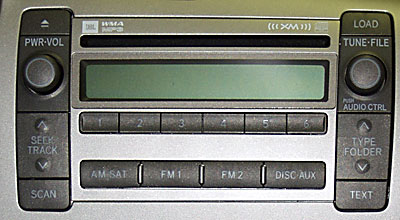

Below are the general guidelines for connecting Grom iPod interface to the Toyota Matrix 2008 car stereo. The installation of GROM adapter requires you to pull out the car stereo in order to access the CD changer port located at the back of the car radio.

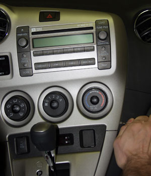

  2. Using screwdriver carefully detach the decorative cover.

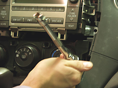

  3. Unscrew 4 10 mm bolts located at the stereo corners. Be careful not to loose them!
  4. Carefully pull out the stereo in order to access 12-pin port at its back. Don't disconnect any wires, the port should be empty if you don't have navigation or XM installed.
