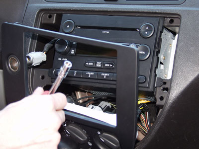

  2. Take the screwdriver, carefully insert the slothead between the car stereo trim and dashboard. Gently remove the car stereo trim.
  3. Now you see the stereo and 4 screws at the stereo corners.

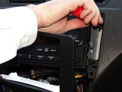

  4. Take the phillips driver and unscrew 4 screws at the stereo corners.

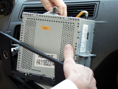

  5. Gently pull the stereo out, be careful not to disconnect any wires.

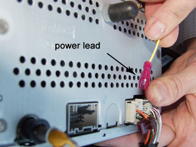

  7. Locate the power lid (yellow wire with the pink colored quick disconnect terminal on the end).
  8. Locate the main harness at the back of the Ford stereo, find the red colored power wire on it.
  9. Snap the T-Tap clip (provided with your GROM package) over the red wire on the main harness so it is fastened
  10. Connect the power lid to the red power wire on the main harness as shown below. You can simply snap the pink disconnect with the closed T-Tap clip on the red harness.
