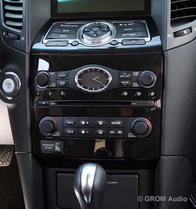

  1. Here is the original stereo of Infiniti FX35 2009. The passengers and drivers soon will be able to access, play and control the music, stored on the flash drive or iPod, via factory stereo.

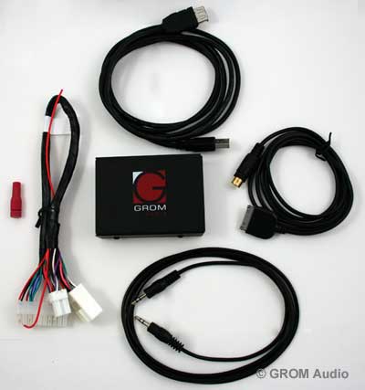

  2. GROM USB MP3 kit consists of GROM main module, vehicle specific radio cable NIS2, USB cable, and optional iPod and AUX 3.5mm cables
  3. The GROM-USB MP3 Car kit for Nissan/Infiniti consists of GROM main module, vehicle specific radio cable NIS2, USB cable, and optional iPod and AUX 3.5mm cables.

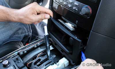

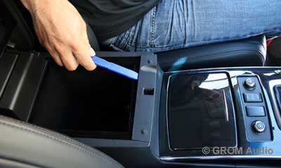

  5. Open center console lid and remove front trim piece by lifting up under lip.
  6. Installation of GROM USB MP3 and iPod  adapter in Infiniti FX35 2009 - step2

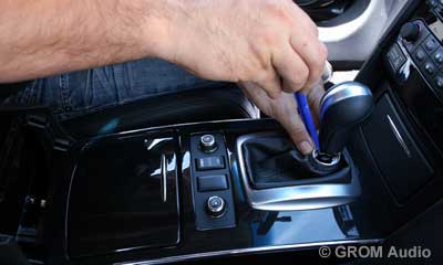

  7. Remove shifter knob by sliding the trim ring down and removing metal retainer clip.
  8. Installation of GROM USB MP3 and iPod  adapter in Infiniti FX35 2009 - step3

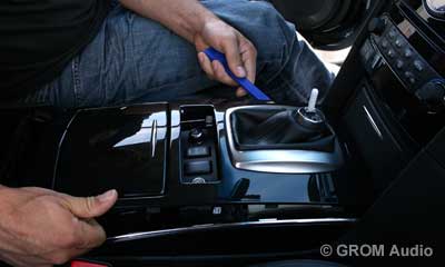

  9. Starting from the rear of the center console panel, gently lift up working forward.
  10. Installation of GROM USB MP3 and iPod  adapter in Infiniti FX35 2009 - step4

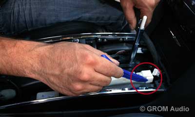

  11. Disconnect the white plug and place the assembly aside.
  12. Installation of GROM USB MP3 and iPod  adapter in Infiniti FX35 2009 - step5

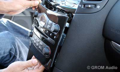

  17. Panel will slide down and away. Disconnect the four plugs.
  18. Installation of GROM USB MP3 and iPod  adapter in Infiniti FX35 2009 - step8

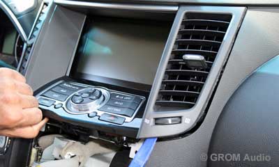

  19. Remove two screws that hold in the top controls and vents. Gently pull out as one assembly.
  20. Installation of GROM USB MP3 and iPod  adapter in Infiniti FX35 2009 - step9

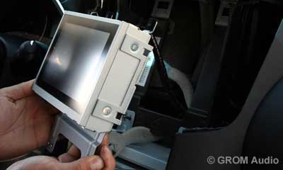

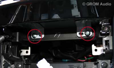

  21. Remove the top two screws that attach to the metal brackets. Pull the monitor/display bottom out and then slide down.
  22. Installation of GROM USB MP3 and iPod  adapter in Infiniti FX35 2009 - step10
  23. Disconnect the plug at the rear of the monitor/display.
  24. Installation of GROM USB MP3 and iPod  adapter in Infiniti FX35 2009 - step11

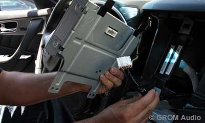

  25. Remove the bottom two screws of the radio assembly. Protect center console and slide out radio to access rear radio ports.
  26. Installation of GROM USB MP3 and iPod  adapter in Infiniti FX35 2009 - step12

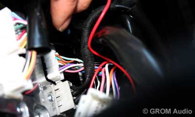

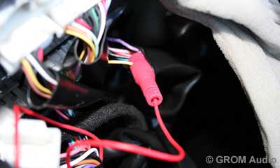

  27. Connect the red wire of the vehicle-specific NIS2 harness to the radios 12 volt constant power source using the supplied Posi-tap.
  28. Installation of GROM USB MP3 and iPod  adapter in Infiniti FX35 2009 - step13

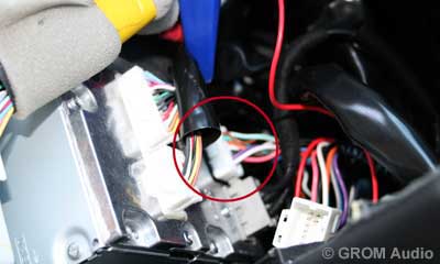

  29. Connect the white plugs of the NIS2 harness inline with the factory radio harness.
  30. Installation of GROM USB MP3 and iPod  adapter in Infiniti FX35 2009 - step14

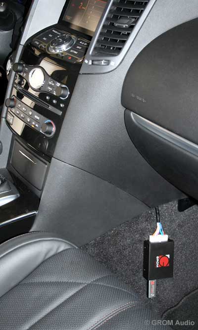

  31. You may mount the GROM USB unit behind the radio (USB extension is included) or place near the glove compartment as shown on the picture.

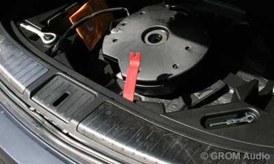

  35. Open your trunk. Remove the rear door plastic panel.
  36. Installation of GROM USB MP3 and iPod  adapter in Infiniti FX35 2009 - step16

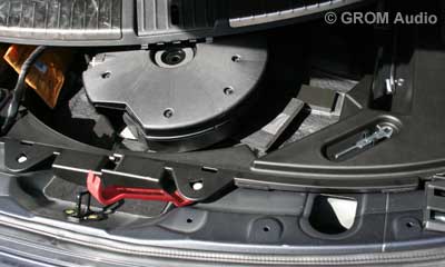

  37. Remove the spare tire
  38. Installation of GROM USB MP3 and iPod  adapter in Infiniti FX35 2009 - step17

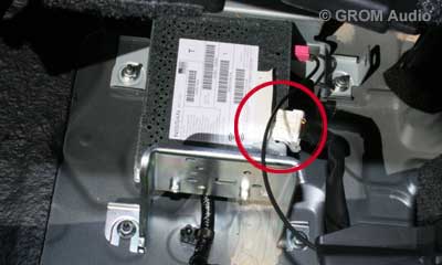

  39. Locate the factory installed XM tuner. Disconnect the white plug as shown on the picture above.
